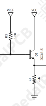

We can also build a buffer with a regular BJT. Here's the input buffer from the LGSM. Pretty much the same as the JFET buffer, above. The only difference is we have to bias the transistor from Vref instead of GND. Some JFET buffers use Vref to bias the gate.

How is Vref usually implemented? And if Vref is a reference voltage why is there a resistor between it and the base?
Look at any of the PedalPCB boards that use an opamp for examples.
Vref has a bypass cap and is therefore at AC ground. If you connect Vref directly to the base of a transistor, then that transistor's base is also at AC ground and the signal is shorted to GND.
Ah that makes sense. I read about that for opamp biasing recently but didn’t put the two things together. Thank you Chuck!
