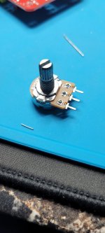

I bought a bunch of cheap pots to save some money but I could only get those "PCB mounted" or whatever they are called. They work fine (a little off tolerance but not too bad). Only thing is I need to solder legs to the ends. I use cut off leads from LED's, Caps, etc. I've been using a clothespin to hold to pot while trying to line up the leads to the pot leads. It's gets a but tedious. For S&G's I just wanted to ask if anyone else had any quicks tips or tricks to using these pots. 20230707_142623.jpg

I treated the leg rivets as solder lugs. Threaded bare wire through them and bent the wire over flush to the leg. Soldered to the leg. Thought it would be more structurally sound that way.

Thanks for sharing. I was wondering if that was an option as well. After the feedback from this thread I think solid bare wire for sure is the way to go. And wrap around those rivets or even the posts. I'm going to try that. The more I do I can get in a rhythm and knock them out.
I worry about movement of the wire while the solder transitions to solid, causing cold joints. Probably not a big deal, but it's bringing me down. So I laid out this helper for wired pots and just got the first draft from JLC today. I included some pads for adding fixed resistors to change the taper/value of a pot. The holes are 1mm and pretty tight, which I think is a good thing in this case, accepting the old maxim that one shouldn't rely on the solder joint for mechanical strength.

Is this not getting more expensive than right angle pots at this point?
And adding more solder/failure points?
I’ve used little sections of tagboard on these pcb pin pots before to attach solid core wire but it was more trouble than it’s worth, so now I just buy whichever pots are available and solder some solid core wire to the pins, like above. Never had a failure but also I’m not selling them nor gigging with them.

Yeah I think Tayda's right angle pots cost around 10 cents more, and that's less than the boards cost at around 20 cents. It does makes sense for boards designed for wired pots, etched/vero, changing the pot layout to reuse an enclosure, etc. Also helps use up those pots accumulated due to drunken order mistakes 🙃
