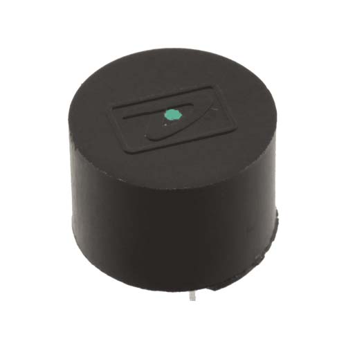

Hi! I recently bought and started building a Conquerer Fuzz before I realized I don’t have a 500mH Fasel inductor.
These seem hard to come by, also, I’ve seen in another thread that @Robert said the the board has been updated to use a variety of inductors, including the TM013-R.
After combing the forum I found a few other posts where people have used 5 100mH inductors, or a 42tl013, as well as other inductors or transformers.
I’m wondering is there is a full list of usuable inductors/transformers/other components available anywhere, or if this can be posted on this thread, so that this info can be centralized and help future n00bs like myself.
I’ve often seen @Chuck D. Bones in these threads, Chuck I want to say thanks, nice to meet you, would be glad and appreciate it if you have any input.
Edit - I’ll update the list below from people’s comments to keep everything together.
Me-6 / Mammoth/StompBox Out of Stock as of 5.6.2024 (thanks @Harry Klippton)
Small Bear - 470mh Wilco axial-lead inductor, also carries Dunlop wah inductor (thanks @jwin615 )
42TM013 Transformer / Banzai / Mouser (thanks @Synchrony Pedalworks @jwin615 )
