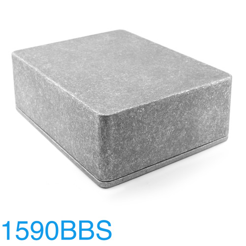

I like that Tayda offers powder coated 1590BB enclosures but wish they were the slightly deeper BBM size. Decided to make up an adapter ring to sit between lid and box to give some extra room. It’s just 3D printed for now but maybe I’ll machine these on the mill especially to make a deeper 1590B. For now this just helps with a certain build I’m doing.

Just use longer screws on the corners? 3-D templates for rings for standard size enclosures is a good idea for those "oops" builds where there was perhaps a tiny miscalculation on the cap sizes or something.

Yup exactly just a longer 6-32. Screws will keep the lid grounded and I doubt that the spacer will let in much noise.

This will make my next build easier for Jack clearance but the thing I didn’t think of is how close the Electrolytic caps would be to the lid. Also makes working with off board pots easier because you have more room

That’s a very good idea, easy to run out of headroom with too-tall electrolytic caps with the bb enclosures. I’m too used to the depth of the 125b’s.
