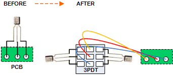

I want to mod my rangefinder by adding a switch (or array) to go between different transistors. Is there a best-practice method for wiring something like this up? I was hoping a 3pdt on/on would work, but I'm also super new to this.

It can be done, but can I ask why?
Not sure you'll gain a ton vs the biasing issues you may have. I.e., the bias setting that's best for one transistor may not match the next. For Si, this is much less of a problem but for Ge, it could be a big issue.
If you find 2 germs that sound good without rebiasing, then yeah, a 3pdt will work.
You can usually get by with 2 poles, but it's probably not worth the effort in this circuit/easier to just mount them to the switch.
Get a switch with lugs, not pc pins, and wrap the legs through it for an easier time soldering. Match C, B, and E on each side and to the PCB.

I have an OC76 and a CV7007 that bias out within .1V of each other when swapped and I can't decide which one I prefer so I figured why not both. Ive been swapping them back and forth for a while and decided I like both and they feel different enough to have in one circuit. The OC76 has a little less low end and more aggression while the CV7007 feels a little thicker/smoother.

More than likely, you'll want to use the 3PDT method:
When there's a common-leg, you can get away with a DPDT

Keep in mind @BJG that with you switch as is, the BIAS control will only be useful when the selector switch is engaged one way. Not sure if you want to incorporate that or not into both transistors.
You could always include bias resistor(s) in the switched transistor sub-network. The switched resistors could be all or only part of the total bias resistance, but are enough that both transistors are optimally biased.
