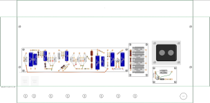

I have a Champ board I've finished and I'm going to be doing that next but after that it's a blackface princeton reverb! This is my unfinished layout for the chassis/faceplace I got from ZackMDHunter on eBay. Same dimensions as Mojo, a lot cheaper.

What about the turrets do you prefer vs eyelets. Couple of the eyelets I noticed get a little packed
Turrets better hands down. You have room to run the wires on top of the board instead of under it because the components don't touch the board. You can still pack three wires in the top of the turret and easily wrap two around the column in the recesses, and then one in between those.
When I got to meet Leo Fender, he espoused to me to become an amp builder and one of the things he mentioned that he liked about Marshall amps more than his were turrets. He said he'd use them too but they're just much machining to make them. Leo made a lot of the parts in his amps.
That said, there's a lot of 3D complexity in laying out a board with turrets in one of Leo's VERY small tweed chassis. After the tweeds he moved to a larger chassis with a different orientation on the tubes and control panel...
