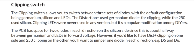

So I built an Aion Aphelion which is their Dist+/250. This pcb has a clipping switch to go from Silicon to Germanium to LED clipping. The thing I'm confused about is how the documentation talks about wiring the silicon clipping. There are spaces for 4 diodes in the silicon section, but they say to jumper 2 of them by default which I've done. It does sound a hair shitty. Am I supposed to use 4 1N914s?
