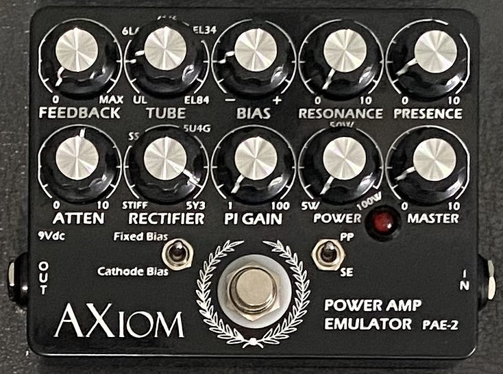

No they're not. They are preamp + poweramp emulations. Hence my question: can I drive the poweramp section of any of these circuits with a REAL tube preamp and use a speaker emulator after the poweramp emulator without impedance problems? If so, would a buffer be a good idea akd a fix?

So you want a "REAL tube preamp" > Mofeta/Thunderbird > speaker emulator...
I don't see a problem with that. A buffer shouldn't be a problem, neither the Mofeta nor T-bird are like a Fuzz Face.
Have you looked at the Mofeta and T-bird schematics to determine which part is emulating the amplifiers?
I'm guessing for the PPCB Mofeta, the power-amp emulation comes after the tone-stack at C15, but then you lose a big part of what makes the Mofeta sound like it does.
For the T-bird, I couldn't say what's "power-amp", to my eyes it looks like the whole circuit is part and parcel.

Would it be possible to use the poweramp section of, say the Mofeta or the Thunderbird, with a REAL tube preamp and a speaker emulator after it?
Would there be an impedance mismatch between the preamp output and any of these poweramp's input?
If so, would that be fixed with a buffered output to enter the poweramp with a low impedance signal?
These parts aren't strictly power amplifiers. They only simulate certain aspects of PA "sound" and behavior.
