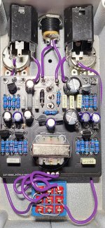

DeeBattery
I just completed a Conqueror Fuzz clone. I've done 7 pedals before this and made sure to get all the joints and values right. I give it 9v and I got nothing. I was so pissed I bought a clone on ebay to check against what I did and it looks damn similar. I'm will to ship to you to figure it out. Anyone up for it? I have not installed a LED yet but don't think that matters.

Any chance the hot wire from the output jack is touching the back of that one potentiometer? On that note, are you not using dust caps at all?

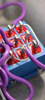

Also the bottom lug of the spdt switch seems like it's not soldered, but that could be the angle.
Those connections all look like they should be able to be soldered from the 4 or 3 holes and still be the same connection. I'm close to Chicago and I came take this apart in a few min to show the backside.
