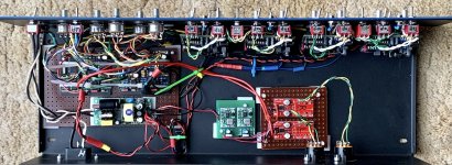

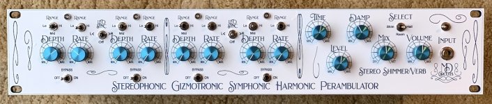

Sure have. Over a dozen Arachnid platforms, two other Deflector builds, a couple of Binaura builds and in one-off custom rack-mount build (I'll never do it again) for a pro studio in LA. The custom rack-mount build is my flagship of "Stereophonic Gizmotronic Symphonic Harmonic Perambulator" constructs. It has four GuitarPCB "Mini-Me" chorus circuits and two PedalPCB "Pythagoras" builds with custom FV-1 patches created in the 'SpinCAD Designer' app.

the rack mount is incredible, long term I'm very interested in studio gear so this is good motivation for me.
