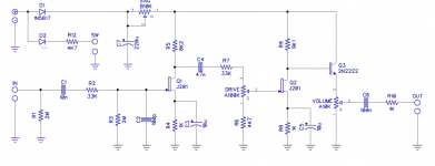

A few months ago I built one of these using through hole J201s from Mouser. I like the pedal but I wish it had more gain and I really can't hear much difference no matter where I set the Sag knob.
Would adding trim pots let me bias the J201's a bit better? I assume that would that be R5 and R9? Is there a way to get more starve action from the Sag, like can I just increase the B10K value?
Thanks
