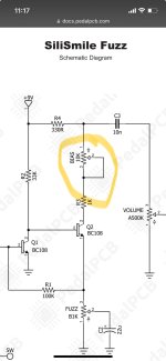

I am starting to bread board now and thought the fuzz face was a good place to start. The silismile looks interesting and close to the original:
Question, the separate lower power section in the schematic, if I am not using a stomp or LED in my model, can this be omitted? Is D100 and c100 required?
Thanks, I am just trying to get the picture straight in my head.

D100 provides reverse polarity protection, in case you inadvertently reverse 9V and ground, with the 47u cap there to filter said power. The LED’s useful to confirm that the board is getting power. But you could connect directly if you wish.
That section is the power section. D100 is for polarity protection. If you're confident on powering up the breadboard you can omit this. C100 is a power filter to give you cleaner DC input. It's always good practice to put this in, but not necessary to make a functional circuit. You can simply throw this directly in the power rails on the breadboard and forget about it.
Maybe the diode and 47u cap makes sense for the breadboard. I will try connecting directly.
Thanks. the diode and 47u make sense. I will add them. I was wondering if I could just put this on the power rails. Thanks for confirming. Maybe I will keep it as is and just move to the power rails.

Hmm, looked at the schematic again. C100 makes sense on the power rail, as you said. D100 is not clear where to add it. I might as well put in the diode in case I snap the batter on wrong. would it go in the "IN" section?

Nope. Plug your power input into the diode and then the diode into the power rails. If polarity is incorrect then nothing will reach the rails. C100 goes directly in the power rails.

Ok so it has to contracted back to the same as pin 3?

Exactly. If you're using a wired pot for this, you can bridge pins 2 and 3 on the pot itself, or better still IMO solder all three leads to the pot for later re-use. Then connect pins 2 and 3 to the same column on the breadboard. If using a trimmer, make a small u-shaped bridge from solid wire (offset from a resistor or diode lead) and connect trimmer pins 2 and 3 accordingly.
