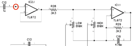

alright, here it is.
finished a HM-2 build on the breadboard this arvo. it's gnarly. gotta do a demo soon.
so tonight i plotted out a russian muff on the free space left (minus tone circuit & q4), and got it running into the HM-2 EQ.
but it’s 1:45am so i can’t properly test or hear it yet, but it’s working well. keen.
(3x 2N5088, Q3 collector -> 4.7uF -> non-inverting input of buffer stage immediately prior to the EQ stage)

Awesome, can't wait to hear that!
One thing to consider - if we max the tone controls, the opamp's gonna clip due to the amplitude coming from the last bjt. It'd be better to stick e.g. a 68k-33k voltage divider before the buffer to make sure not to hit the rails at the EQ...
i only realized upon revisiting this thread that i forgot to do this. probably would have been a good idea.

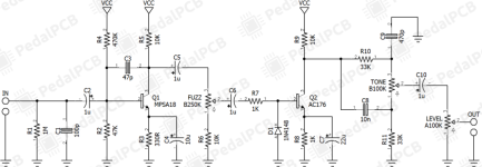

after haphazardly dropping a War Scythe in the cart for the BF sale, i decided I should probably check out the Tone Reaper / Scythe Fuzz section as i had no idea what to expect (since nobody has been building these, and i dont think i've seen anyone post a demo of a War Scythe either)
claimed to be a silicon/germanium hybrid take on a Mk III tone bender, where Q1+Q2 are replaced with a single MPSA18, and some other things:
well crap.
this might be one of the sickest fuzz circuits ive tried so far.
i think it might be 'better' than a fuzz face. and i love fuzz face.
It's just so beastly and thicccc, but without any mud.
i'm actually shocked that this Scythe Fuzz / Tone Reaper standalone circuit isn't more popular.
(probably cos everyone does what I did and just goes for the War Scythe i guess)
some notes:
- given the lack of bias resistors, i assumed Q2 (NPN Ge) would need to be quite leaky.
gainleakQ2c idle bias

- at the moment, I'm not sure how high that Q2c bias can go before it starts to sound shit.
- I didn't really feel like wasting time to see how far it can go, so i only tested the two units above to see how the sound would be affected by Q2c bias.
- both of these sounded very close. barely any perceptible difference.
if i had to choose, the higher leakage unit did sound better to my ears.
[but not enough to want to make that pinout (BCE) fit the PCB footprint (CBE), so I'll be going with the MN11A on the War Scythe build]

so after getting very excited about how cool this fuzz is, i breadboarded the rest of the War Scythe, as it seems every other post about it is some poor sod having issues with the octave section...
got it all running, and yep, this War Scythe thing is a winner. can't wait to build it.
here's the Tone Reaper / Scythe Fuzz in all its thicc glory:
