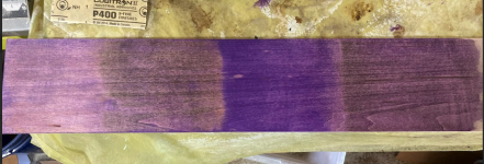

Alright, I tried one more experiment with stain that I was relatively please with. The left 2 spots were first treated with wood conditioner. The first one is just purple (2-3 coats). The second is black that was sanded back then 2 coats of purple. The right 2 spots are untreated: 3 coats purple and a knocked back black with a single coat of purple. Of these 4, I'm going with the untreated black/purple. This whole process took a while since I had to put a coat on and wait a day to resume.

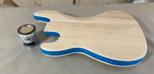

From my first kit build I remembered that the end grain, regardless of wood type, will suck up 235543634 times more stain than face grain. Since I don't really want to sand the end grain too much and start messing up the overall shape I decided to get some painters tape to keep the black away from it. I'll stain one side, retape it, then do the other side in black (or in this case ebony).
And just what I thought would happen did happen. It is very blotchy, but I'm not SUPER concerned right now since I'll be knocking it back with sandpaper (220 grit). I'll need to make sure the stain is dry enough otherwise I'll go through a whole pack of sandpaper. Sometimes you just need to bite the bullet and go with something you're not 100% sure about. Heck, it's just a kit build for me to have fun.

Outside of that middle piece of wood's bottom half, which appears to have taken dye really differently, it just looks like there is some figuring, which when top coated will get it some depth.
Took some more time on lunch break today to chip away at it. I'll look at it again tomorrow, but this may be good enough for the next step. It doesn't need to be perfect since color is going on top of this, plus I'm working with basswood so there will always be blotches. For the record, if I were to do another kit build (probably will at some point) I'd choose a different wood for the body. It would be worth the extra $ for more consistent stain. If I choose to stain, that is :)
