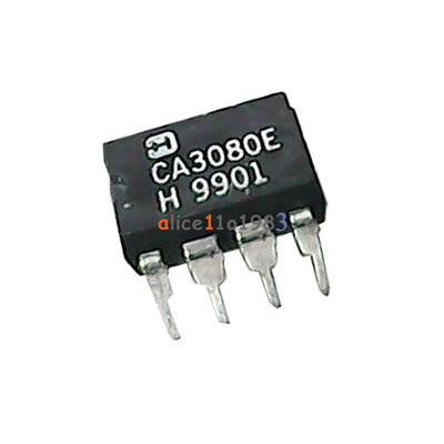

I just ordered another IC from a reputable company to try, this time a CA3080e for $7. The CA3080ez I have in there now was cheaper than that and ordered from eBay.
Shows dodgy Harris mockup & sends so called Intersil that looks dodgy from China is a pretty good bet it's a Fake!
I should have picked up on this earlier, Fakes have been around for years with this Chip!

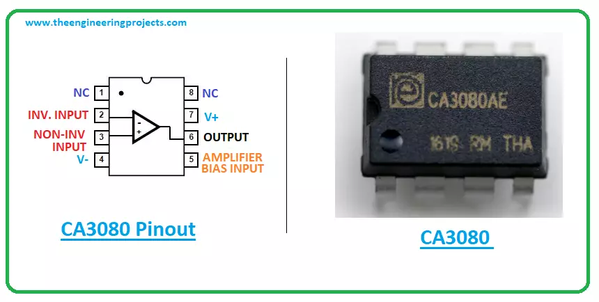

Where did you get that pinout for the NTE996? It's an OTA like the CA3080. I don't know what (if anything) that suffix means, though. I've only come across AE packages.
I just typed in "pinout" with each IC name and that's what popped up. I haven't looked at the datasheets of either IC yet.
Sorry if that isn't accurate, I was headed out the door when I posted the pinouts and didn't have time to cross-check.
