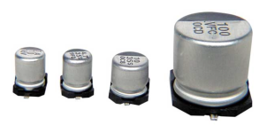

what electrolytics are you using in that picture? I like the look of them and am obviously swayed by aesthetics :ROFLMAO:
The electrolytic caps I use these days are SMD caps. You gently pry the little black plastic base off and then you have two little legs to solder to the Vero.
I learnt this trick on this very site. Tayda sell some but I get mine mostly from Mouser. I like them because they're tiny. The legs are a little more delicate than regular through hole caps but if you're careful you'll be fine. The leg spacing varies because they're not designed to be used this way but generally they will fit.
What I like is that you have your own thing going on. I have my way which is anal and boring, you have your more idiosyncratic way which is cooler! As long as you follow the circuit and don't create noise or oscillation there is very little which is right or wrong.
