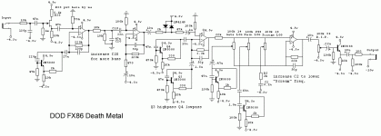

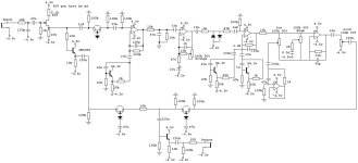

I've found that thread in the past while searching for a fix. In the thread he also has a hard time finding the actual schematic so he provided one for the DOD FX86 which I believe is the same circuit under a rebranding. I know a few of the DOD/Digitech pedals are just modified circuits of their Grunge pedal. I will attach both the schematic that he posted and one for the Grunge.
Examining u3 it reads 14007UG PAA707. Doing a quick search I was able to find this: https://www.onsemi.com/pdf/datasheet/mc14007ub-d.pdf
Being able to read and decipher a schematic is beyond my capability at the moment. Would u3 be a part of the switching relay?
OK, it looks like it is a FET switching setup, but the switching bit is mostly missing from the schematic. If you see the lower schematic of the 2, there are 2 FETs at the bottom near the output (unfortunately they are not marked with component numbers so I can't point out better than that. One of the FETs is letting through bypass signal and the other is letting through the effect signal. There is a good description here about how the system works www.geofex.com/Article_Folders/bosstech.pdf
I would guess that if you can get effected sound through then both FETS are probably working, but the mechanism that swaps from one to the other being active is probably a little wonky
After a little more digging I was able to find a better schematic for the DOD FX69 (Grunge) with the component numbers listed. Comparing the two it looks like the two FETs you were describing could be Q10 and Q4? They're listed as a J201.
(I'm using this sheet I found as a reference: https://www.futurlec.com/Datasheet/Transistor/J201.pdf)

Yes. Q4 is for bypass, and Q10 carries the effect signal. It is the network around U3 that is doing the switching. Does the LED turn on when the effect is working and off when the effect is bypassed?

It sounds as if almost everything is working as it should. Sounds like you won't need to replace U3 fingers crossed. I am a little hazey on exactly how this bypass works, but from my understanding I would be suspicious of the capacitor that is labelled C16 in the above schematic. I think it's purpose is to discharge and charge with the change of state and I think that if it is not doing that properly then the system may not stay in a steady state well. Somebody else with a bit better knowledge of this type of bypass may be able to say with more certainty
Sound like the cd4007 is failing. It's being used to switch but isn't "latching"
I'd check the components around it as well. C6 and the half dozen resistors for opens.
