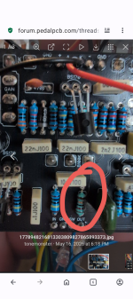

Hey greetings from Germany,
I build the distortr https://www.pedalpcb.com/product/pcb014/
I think it's the 20th Pedal that I build.
All worked fine, but not this Distortr!
Bypass signal works.
When the pedal is on its very very very quiet.
The vol and gain potis working,
There is a very quiet sound out of the amp.
But... When I turn the tone poti clockwise the quite loudness is gone. There's no sound it's quite dead. What could it be?
Thanks Klaus

I found this....
Than is that part wrong too i think...? I am a little colour blind. I think I've over read the K a the parts label

Holy moly thanks 🙏🏼! It works. Wat a great Pedal.
This sounds huge and dynamic!
Tele mach1 DRV hotcake distortr badcat cub!
Very very great pushed sounds 🥰
Big thanks for your help!
