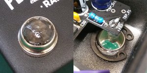

If you don’t mind I’m totally going to do this same decal that is very nice! Might put one of those fender amp jewels on there though with a white led under it
Go for it, I have used fender amp jewels a few times.
Be careful how you mount it as it can stick too far out internally & foul on the PCB!

I need to find out what Electrical thread pitch it is and you can just buy the Jewel & nut.
I've looked at Fibre washers & rubber O rings but they didn't meet my standards!
You could also use kneaded epoxy, I found this stuff is really good for plugging up holes & chip outs!
You just slice a piece off & squeeze it between your fingers to mix the 2 different colours together.
The downside is you can't remove the Jewel as it sets like concrete!!!
It is 9/16-24TPI, Look for 9/16-24 Jam Nut in description!

I found these bezels on Mouser. They are push in like the ones sold in the store here. Similar but different. The LED on the right is floating below the bezel. The LED on the left is nested up into the bezel.
And they're 5mm clear UV LED's.
