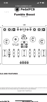

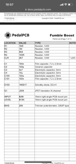

Hey man. This is great info. I actually do quite a bit of soldering for many different applications but I guess not this small now that I think if it. Im just not sure that I am ordering exactly the right caps and resistors based on what this chart is telling me also the numbers on the list don’t exactly match the locations I see on the board diagram. I will attach pics.
See how there is a c14 on the diagram but no c14 on the list? Sorry for so much info. Just a bit confusing.
I'm not at home right now so I don't have the board on hand to verify, but I'm pretty sure C14 on the diagram is actually C1, C6 is C2. I'm pretty sure if you order everything on the BOM you'll have what you need. So, two 100n film caps, one 100p ceramic, and all 3 electrolytics listed.
As mentioned above, Tayda will have pretty much everything you need if you search for it. This circuit runs on a standard 9v so any electrolytics that are rated >= 16v will do the trick. I usually just order electrolytics in bulk that are rated at 50v because that covers all my pedal needs outside of a few special cases with tube-based circuits.

Thank you Ace! No cork sniffery here lol. This is huge help! All of you are awesome. Much much appreciated. I may bug you again if I can’t find the right spots but I hope I’ve got it thank you!

Y'all are the best! Feeling wayyyy more confident now. Great advice and thank you for fixing the Diagram! I will post back here once I get everything all done.
