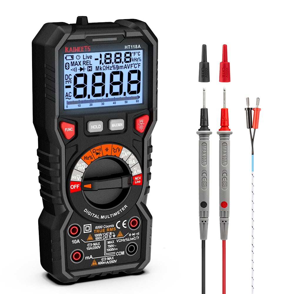

Do you have a DMM that can test resistance for a quick sanity check?
Will test tonight
Just for fun, what does it read when you measure a piece of wire?
1.21 gigawatts!!! I will check this out tonight as well, that is a great idea.

Short all 3 leads and then hit test/turn on.
Your tester looks like it's running similar firmware as the TC series. That's the cal procedure for them.
Getting repeated results makes me think calibration/accuracy issue.
I.e. all 22ks read 27k or whatever

What are you using to test?
Just looked it up:
Just keep in mind that your meter has a +/- (4%+3) accuracy on that range with capacitence.
Basically, if you're measuring 80pF, your cap could be anywhere between 73.8pF and 86.2pF.

I'm not dissing your meter. That's not what's happening here. Your meter is fine.
I'm just pointing out that *even something like my Fluke 87, a $400 meter*, a degree of uncertainty exists.
Measuring tools work like these work within a range. Typically that range is stated by a manufacturer in their official literature. This is how I determined the accuracy of that meter within the range you are measuring:
Scroll down to "parameters".
Sometimes those numbers are fudged by less reputable manufacturers. The meter you posted is by all accounts good enough for pedal building on paper.
Like I said: your meter is fine. Any measuring device needs to be used with an understanding of its limitations. You aren't reading a single value when you measure a component: the value displayed on the screen is indicative of a *range* of values determined by the meter's accuracy.

0. ohms.
So assume it is dialed in
Well, not necessarily... DMMs can be out of tolerance in one range while within spec in others, and the error isn't always linear. I was just curious to see if there might be an obvious offset in the measurement.
The only way to know for sure is to compare it's measurements against a known-good / calibrated meter, or a resistor standard.
When I worked in the calibration lab we had to switch the meter into manual range mode and make several measurements in each range before determining if the meter was within tolerance or not.
With that said, I wouldn't be too concerned about anything less than 10% tolerance in your measurements unless you're doing something really critical (not pedals)... You have to consider the tolerance of the component in addition to the tolerance of the meter, as well as the test conditions.
There's a difference between "Ehh, might be out of tolerance" and "I can't determine if this component is defective or not." .
So there seems to be a trend starting at 20k. (Yes I got bored and tested one of each resistor value last night)
15k - 15.14
18k - 18.07
20k - 16.2
22k - 18.2
24k - 20.1
27k - 23.4
Seems to go up to 47k then is 5% off until 200k

Hmm.
Are those resistors all from the same source?
The only thing that gives me pause there is the transition from 18k to 22k. I'm not sure what would cause the 18K to read accurately, but for the 20k to drop to 16k.
But it does seem to indicate that this meter may have a difficulty with measuring resistances higher than 20k. You may find that this offset only occurs in that specific range: what does a 100k or 470k or 1M look like on there?
Either that or the specific batch of resistors you have there in the over 20k range exhibits a similar issue to what I've seen on many of the resistors that I've bought on Amazon: poor QC, possibly reject batches from large manufacturers that got re-packaged and sold by some disreputable folks looking to make a quick buck off trash.
Same vendor, same resistors not from Amazon, but a supplier that gets mentioned here often.
Higher up like 470k are within spec.
