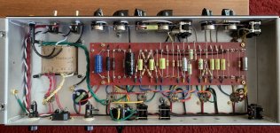

I really don't care about doing this for pedal pcbs because it is not needed but Mojotone bends their amp capacitor and resistor leads to fit them in the cool partitioned plastic parts boxes they include with their kits. I want the wire leads to be perfectly straight to look good on the turret board.
What's the best way to straighten these wire leads?
I use my index, thumb and try to get right at the bend point. Bend it slightly past 180 the opposite way, then pinch and slide your fingers out to try and straighten it.
Redo until happy.
