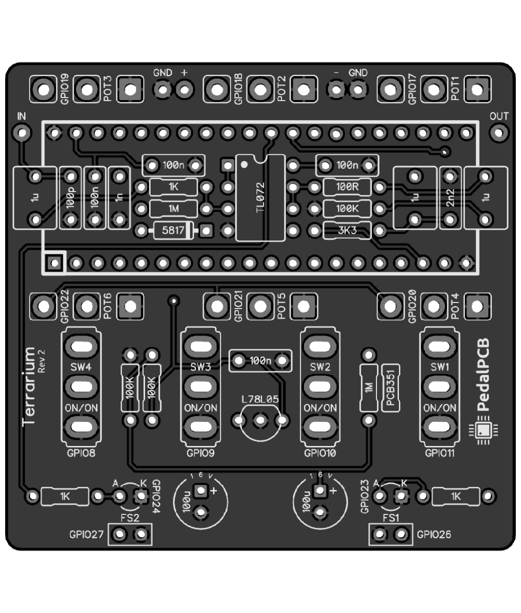

If you want more than 1000 ms, just go for a Terrarium !
Didn't know anything about this before today. Does the Terrarium run algorithms that sound as good as FV1?? It looks like you can make this do multple things as well but the details seem a bit vague. Am I right in that it just can run 1 algorithm only but you can change that through USB? I notice that it requires the Daisy seed but they are currently sold out.
Daisy is WAY MORE powerful than FV-1...
There's a dedicated forum here just for Terrarium :
https://forum.pedalpcb.com/forums/electro-smith-daisy-development.17/
Sadly, so far, we got only about 4 or 5 algorithms to play with and/or modify.
