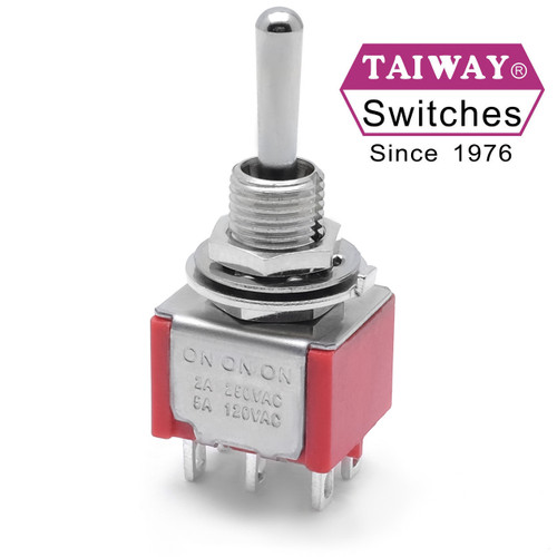

Hey the part number for the new layout for the hyped fuzz had the dpdt listed I cant seem to figure out which one I need the numbers are different on small bear and Tayda doesnt say..the ones on small bear end with 1M1QE but those are center off and the on on on ones dont match. Can some one point me in the right direction
That's the one. I need to update the build docs with Smallbear part numbers.
The ones Tayda carries will not work.
Tayda says this is Type 2 but you will receive a Maroon colored DPDT Type 1 switch.

All my on-on-on are Type 1, some from Tayda, some from a local brick&mortar, a couple from GuitarPCB, elsewhere.
I've got several builds held up because they need Type 2, which I can never seem to find. I've made inquiries with several suppliers and they either don't understand there are two types, or don't have them, or both don't understand and don't have them (confirmed after ordering blind from a few companies and received Type 1).
Small Bear's shipping is prohibitive for me, so I can't get them there until I have enough items to warrant the $hipping.
Any other places that carry Type II other than Small Bear? Thanks in advance.

Ahh I missed your post above about that. I can't recall how long they've been listed as Type 2, but I know in the past all I've ever gotten from Tayda was Type 1. The drawing could be incorrect depending on whether it's looking at the lugs of the switch or the pads of the PCB.
I'm not even sure that MTS makes a Type 2....
Living in Australia the postage from smallbear of LMS for 1 or 2 switches is insanely expensive. I've had really good success cracking open an type 1 and flipping the rocker for the middle pins 180 degrees. BOOM! Type 2 switch.

Wahhhhooo SUCCESS!
On both counts.
Ordering some stuff from StompBoxParts (thanks @Bobbyd67!) including type 2 switches AND
I've successfully monkeyed a Type 1 > Type 2 !
Took a while, the bits needing swapping were pinned to the centre lugs, no way for me to pinch the pins and remove them, but I managed to force the lugs through the epoxy and swapped the whole shooting match. I had to re-assemble several times, literally DOZENS, tweaking the wee metal bits inside each time (they got pretty badly mangled from me trying to get them out). Really, the most time-consuming part was reassembly due to getting the bits to stay where they're supposed to.
I got it to a point where it would work, but not well enough that I would trust to solder it into a PCB, just offboard wiring. I disassembled one more time, made a final tweak and reassembled and BAM! Like a Neptunian Spice Weasel it made the right sounds and had the right feel at last.
I'm confident enough to put this in the smaller PCB of the two projects needing this type of switch. The larger project will have to wait for shipment from StompBoxParts (Sending it to the GWN, not to my Asian address).
In future, if need be again, I would change how I disassemble this particular brand/type switch, and things won't get as beat up and thus hopefully will reassemble more easily and quickly.
