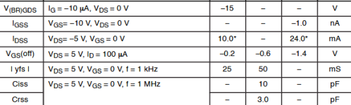

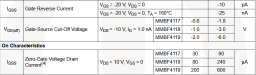

The MMBF5458 is generally unavailable, but the Mouser website offers suggestions for similar transistors.
For example, the 2SK932 (datasheet)
or MMBF4117 (datasheet)
Any experience with them?
There is also TF412S but the SOT-833 package rather discourages its use.

Hard to find a perfect match, especially given the large range of specs.
I tend to go for 2sk208-GR when I have to replace mmbf5458
The 4117's Idss is extremely low, <0.1mA. This means the biasing will have to change when subbing it for 2N5458. It also means that the gain (gm) will be low and the channel resistance will be high.
