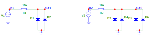

And also, why the f*** did they use 4 diodes (1 parallel pair in each direction) when 2 would’ve done it?! No way it’s due to the pedal’s current draw requirements.

If two are distortion, 4 must be moar distortion. 🤣
I would assume because he liked the clipping characteristics of whatever diode that happens to be but wanted a lower clipping threshold to better match the Ge pair.
(I've never tried running multiples in parallel, so I actually don't really know if that would work)
