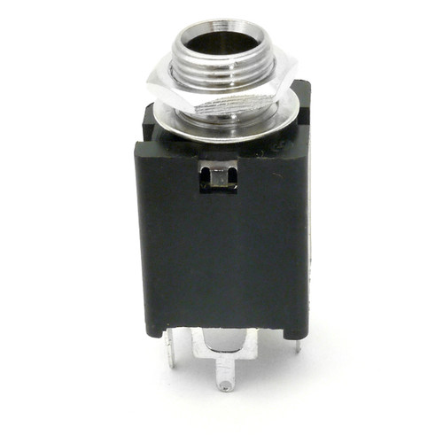

Im returning to pedals building after a few years of hiatus.
Finalizing now my Leprachaun build - I noticed that the Switching Jack I recived from Musikding is one of those 2 SPDT (meaning it got 9 pins ?!)
I see most of your buildings are with a jack having 6 pins.
But I assume I can build it anyhow with the one I got right ?
Trying to figure out what is ment by 'Switching Tip' on the schematic and cant put the dots together.
Can anyone advice me which pins needs to be solder where on the PCB ?
Attaching the Schematic of the Switching Jack from Musikding as well.

mmm still not sure how does the explanation apply exactly to what I need to do.
When Pedal PCB mention 'Switching Tip' - how does it differe from the normal mentioning of 'Tip' ?
is the the position of the Tip while a jack is inserted to the switch ?
What I did when I usually dont understand how switches work I use my Multimeter with the contact position to hear where there is a conduct.
When inserted a stereo jack (with Ring and Tip) - there wasa. connectivity from the Jack's tip to Lug number 4.
When the Jack was not inserted there was connectivity between 2 and 6.
So as you see - my attempt was jumpering these lugs assuming that when building the project without Expression Pedal Switching Jack - there is as well a jumper between the Tip and Switched Tip position of PCB.
Its a first build ever with a Switching Jack fro me after all (and I do not use or have an expression pedal yet, but just wanted it to have the option to use one)
thanks for your help

According to your Musikding Diagram of the switching jack you have...
Essentials:
RING = 8
TIP = 4
SLEEVE = PIN 9
So if the build without the jack requirers a jumper on the TIP, then you need the jack to BREAK the TIP jumper/connection when something is inserted.
Pretty straight forward, now we just need to work out which switched tip to use.
The "?" above needs to be...?
According to KR's StewMac diagram, which at a glance matches the Musikding's numbering (even though the StewMac and Musikding are shown in a different order, the numbering to pins themselves matches)...
The way I see it, there are two options and either one will work:
OPTION 1
PIN 4 wired to the board's "T", AND jumpered to PIN 2
PIN 3 wired to the board's "SWITCHED TIP"
OPTION 2
PIN 4 wired to the board's "T", AND jumpered to PIN 6
PIN 7 wired to the board's "SWITCHED TIP"
Whichever option you choose the other option is left unused...
It's essentially a stereo jack with two switches that can be configured open or closed. So...
