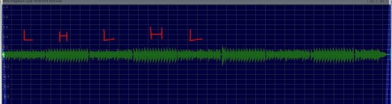

For some reason, all problematic devices (either compressor or chorus) seems to have problem with the same range on my guitar. This makes me think that either the specs of the transistor or some other parts are similar in them. I mean in the ones that have this headroom problem. The swap to 12v PSU doesn't really solve it, either not enough and the other problem with adjusting the distance of peaks of the signal from the headroom limit is that it changes the sound and quality of the effect. What I noticed: the closer the peaks to the headroom limit, the better the effect is. But due to outstanding peaks on some frets it is not possible without distortion.
To check how much the gain of the guitar signal raises after the 20th fret on my guitar, you can check this screen shot, where you can see the gain difference when I am picking an interval on the open strings and at the 24th fret with the same force (the sample sound file of which the photo was taken is also attached):
The difference between L and H needs to be reduced.
How long the sustain is on individual transients: the compressor or limiter should be able to handle almost all notes on the fretboard between frets 20-24, more precisely from F4-E6, that is 349Hz to 1318Hz. And the tempo of adjacent notes is fast, mostly 1008 BPM (song tempo 126 BPM), so the release should be able to handle that.
