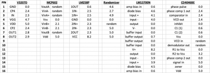

I had asked in another thread about a schematic but starting a new one that is more explicitly about my issue. Getting bypass just fine, LED works fine, also getting voltages on the ICs as well. No sound when engaged however. I know will be limited without a schematic but here is a picture and my measurements if anyone is able to help out. this was one tough build and really want to get it working!
