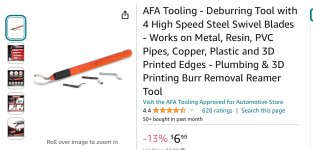

They must have these; no one likes to keep sharp edges on their metal works...
The tool to get rid of sharp edges is a deburring tool. Just a quick sweep around a hole, and the edge gets a nice break to it, without changing the size.
