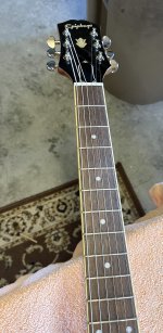

Here's a shot right out of the box before I started my surgery.
The Indian Laurel fingerboard looks nice. Uniform grain and on the darker side. It could definitely pass for rosewood.
I don't have anything against Grover tuners, but I don't care for them in Gibson style guitars. I much prefer the classic look of Kluson's.
So the first thing I did was swap out the Grovers.
I had to use "conversion bushings" to make the Gotoh Kluson style tuners work.
They required a slight bit of reaming to press fit.
Usually on F style guitars I tap these in with a plastic hammer, but since I couldn't lay the neck flat on this guitar I used a C-clamp to press fit the bushings.
There wasn't too much of a "halo" left from the Grover bushings that's very noticeable.
Ahhh much better......
There's a tiny bit of "footprint" from the Grovers showing if you look hard enough, but I think for the most part the tuner swap was a success.
