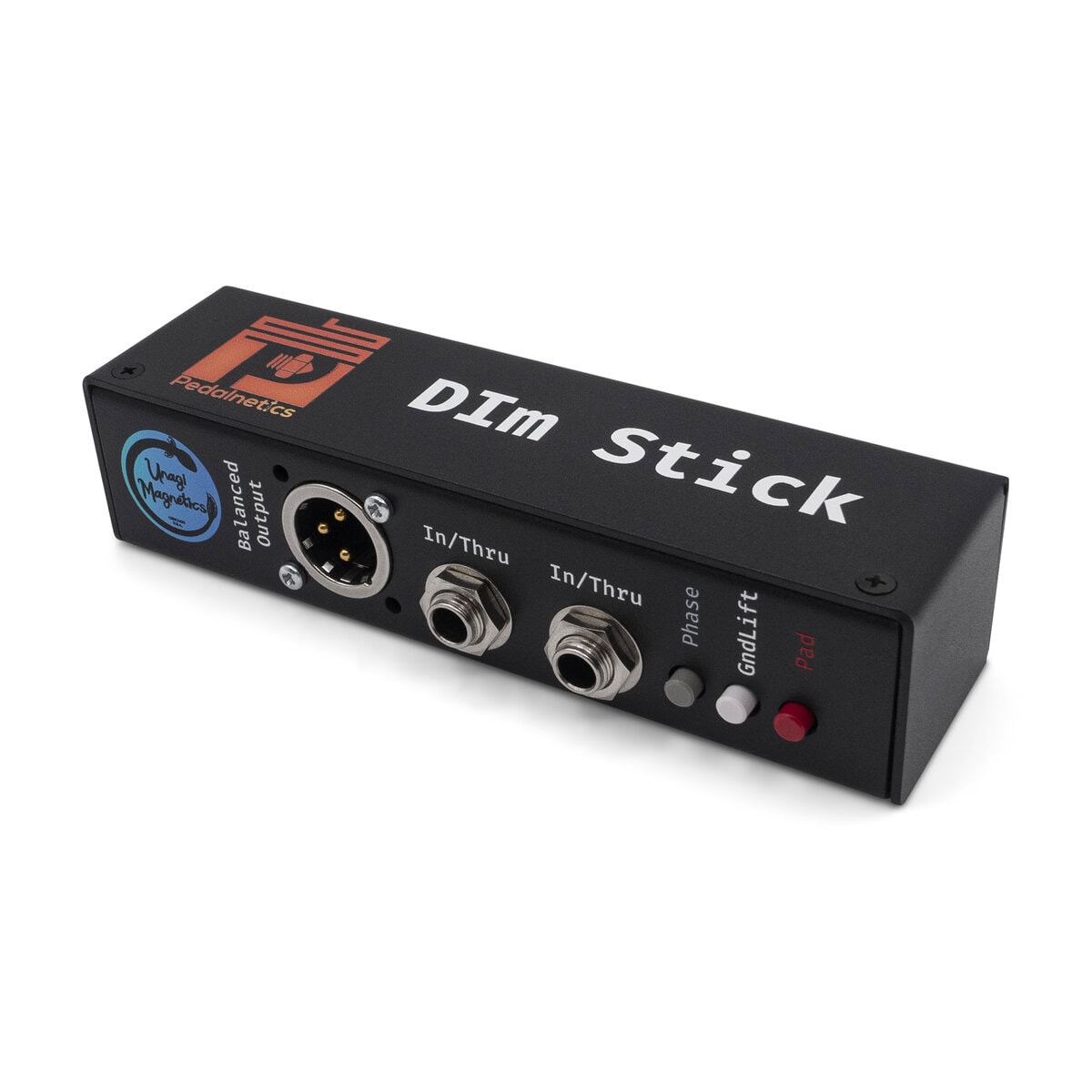

I think what the new switches on that Nobelium that is for sale do is connect the 1/4" input directly to the 1/4" output, also the XLR transformer is connected directly to the 1/4" input socket.
It is a way of bypassing all the electronics in the pedal itself, if you loose power to the pedal you can still get signal to both outputs, the 1/4" signal just goes in and out but the XLR still works through the transformer.
For a passive DI all you need is one of the XLR transformers and a 1/4" socket for input and an XLR socket for output and a box to mount it all in.
I could of course be wrong but that is what I think and that is something I might try on my next Nobelium.
Pedalnetics does just that with their tiny DI box but with a few passive components for ground lift and damping of the signal.
