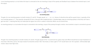

Can someone explain what the part of the circuit below is doing? I assume some kind of filtering for the gain stage, but what exactly is going on... I've tried scouring all over but can't find anything about the series/parallel stuff going on and the what/why. This is from the first stage of the paragon/kot/bluesbreaker, etc.
On the Wampler video he took out the two resistors and capacitors, and just put the 1k resistor with a 220n cap going to ground to boost the gain and it sounded fatter too. He didn't explain the what or why though. I'm trying to understand what's going on instead of paint by numbers.

There's really not enough info in that schematic snippette. Find a comprehensive datasheet for the opamps used in this circuit. A lot of datasheets will have example circuits and how to obtain different gain values determined by the feedback resistor. The R/C configurations are just going to establish a a frequency limit and those frequencies can be determined by some of the many R/C filtering calculators found thru Google searches. Hope this helps.

What you are seeing is actually 2 things: the gain of the opamp (noninverting in the screenshot below since the input goes into pin 3 (+)) as well as tone filters (screenshot even more below). The tone filter is necessary to complete the negative feedback loop in the circuit and more or less "selects" the frequency to get amplified. If you want to read more into it here's a good link. http://www.generalguitargadgets.com/how-to-build-it/technical-help/articles/design-distortion/
