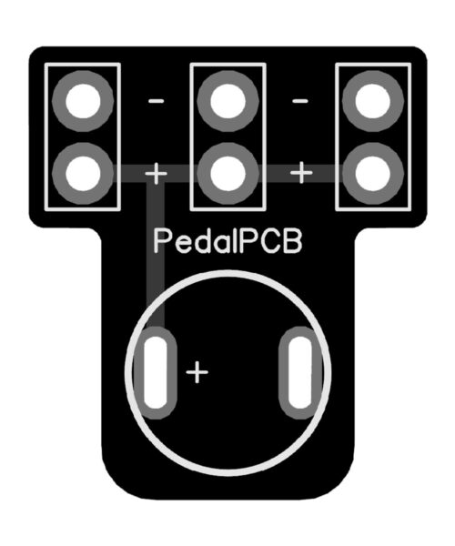

I grabbed one 3PDT order switch breakout board and three 3PDT breakout board. This is how I Frankensteined the dual circuit enclosure:
  1. Wired each circuit to its own footswitch, each with using a 3PDT breakout board.
  2. Wired up the two circuits's breakout boards to the 3PDT order switch PCB as shown on the wiki.
  3. Wired the "in" and "out" from the order switch PCB to the "in" and "out" through holes of the 3PDT breakout board attached to the master bypass 3PDT switch.
  4. Wired the 1/4" jacks to the master bypass breakout board.
  5. Wired the master bypass breakout board's "SW" through hole to the positive lead on the DC jack.
  6. Wired the anode of the LED to the "SW" through hole on the master bypass board and the cathode directly to the negative lead on the DC jack.
  7. Ran positive and negative from the DC jack to their respective through holes on each circuit.
  8. Ran a unified ground between the jacks, the circuits, and the master bypass switch.

The LED wiring on your Master footswitch is at least part of the problem. You're shorting your 9V supply to ground when the Master footswitch is turned on.
You shouldn't be connecting 9V directly to the SW pad. Remove all of the wires from the GND and SW pads of the Master breakout.
Connect the current limiting resistor for your Master LED (the red wire) to the 9V supply, then connect your Cathode wire from the LED to the SW pad of the Master breakout board.
Now connect the GND pad of the Master breakout board to ground.

Wow that did the trick! Thank you for catching that.
