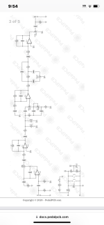

Hello folks I just put this together and it plays fine and all but the sound is very dull it sounds like my amp is covered in thousands of blankets.. there no real brightness or crunch.. it’s pretty bland and dull off a distortion… it doesn’t shred for sure… I’m wondering if the shredmaster is a low gain to mid gain pedal… only thing I did differently was c4 I put a 33nf instead of a 39nf … any thoughts

The Shredmaster is not a high gain pedal by any means. That said, my Oroku is not at all dull. Crunchy at highest gain setting. One of my faves. I wouldn’t imagine your cap sub would make tremendous difference Fwiw.
