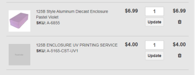

my only issue now, is i'm not sure about what layers are in this design..
looks like i need to specify this for the order:
had a squizz on the reader (yep, im bloody hopeless at this stuff)

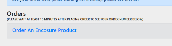

..and then there's the tayda toolbox dashboard.
so I've added the necessary items, but nothing happens or appears here in the tayda tool box thingo
am i supposed to proceed to checkout, pay and complete the order before doing anything in the tayda toolbox?

From what I understand: “Yes” to all questions on the design upload and check all boxes.
You have to buy enclosure and printing service first, then go to the toolbox a few minutes after checking out to designate what gets printed on and what design it gets. Also if you want a gloss layer you have to buy that separately from the UV service (make sure it goes on the same order).
It’s like buying credits. Say you buy 10 x 125B printing services, 10 x different color 125B enclosures, but only 5 x gloss layers. After checkout, you can go to the toolbox and designate which enclosure gets what:
Enclosure 1 (blue)
• UV service
• Gloss
• uploaded design A
Enclosure 2 (green)
• UV service
• uploaded design B
etc…
