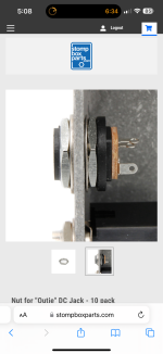

I currently use the type of connector below. Unfortunately, you can’t remove it without unsoldering, which often destroys the plug.
As I have most of my pedals unlabeled, waiting to get a few more done to maximize use of the sheets. As such I’m likely going to have to remove everything to apply decals/clearcoat.
That said, has anyone used spade connectors to attach to the jack, or something like a micro wago connector (if it exists)?

If you add an extra nut on the inside, an Outie doesn’t end up sticking out nearly as far, about on-par with the small Lumbergs. Worth a shot!View attachment 68868
Not a bad thought. May do this when I burn through the rest of my innies.
Although now it means I will have to drill every enclosure (at least one hole) vs using predrilled out of the box
such a big hole for the innie though.
and then you can't use these (well, not without reaming it)
you could try, instead of threading the power leads through the solder tags of the jack, just tack it on with a light amount of solder if you plan to pull it later on.

Indeed, whenever I use a pre-drilled Tayda, minimum I have to ream out the LED hole to 6mm for the bezels I use and 1/2” for the DC Jack. Takes maybe 30 seconds and lets me use the parts I prefer though
That isn’t a bad idea. So simple that I’m kicking myself for not thinking of it!!
