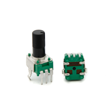

I decided to do the faceplate as you can see. Which worked out nicely. Getting the footswitches in around the board was TIGHT but it worked out. Love the cleanliness of the daughterboards with the headers. Though I had to kind of bend my headers to get it to line up just right. I do wish there was a little more room for knobs with the 9mm print. I’m assuming the idea was to use something w/out a knob there? Going to see what I can find I like there.
Was thinking of actually splurging and doing some nice aluminum knobs through out here since I have to order some special knobs for it anyways for the 9mm.

I see what you mean about the gain and shape knobs/labels.
You should be able to find something slim.

These are the 9mm pots you’d want to use with it.
I didn’t think that far ahead when I ordered/put it together :)
LMS has a nice knurled at 10.2mm, haven’t found anything yet for smooth haven’t looked that hard yet.
