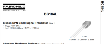

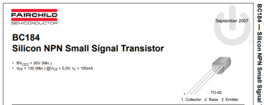

I thought of one more thing because I noted earlier all parts as spec’ed but I used a BC184L sourced from Small Bear and a BC184 is spec'ed. Would the BC184L be a problem?

If you have another medium gain BJT NPN lying around, like a 2N2222 (same pinout as BC184) you could try that instead. Maybe put it in a socket.
