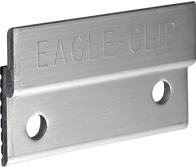

Anyway to add some device to hold the board in place when it is in the suitcase? I have a similar designed idea in a tool box, but since it's alway upright there's no worry about it the board shifting and moving my pedal settings.

The plan is to use a combination of "EAGLE CLIPS" and an inch or two of dual-lock tape to fix it to the wall of the suitcase.
I'm sort-of making-up this aspect of the build as I go along so it's hard to say what it will end up being, but since he's borrowing a number of my builds, I'm quite motivated to ensure it doesn't rattle around in there!
