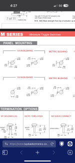

Poe's law strikes again it seems. I know I like to $#!@post, but I genuinely assumed they were meant to align switches in a panel (I assumed the same thing about the nubs on pots). But if that's wrong, I'd like to know. I mean, I don't think I'll apply that in pedal building, but maybe. I dunno. Not an expert on everything (or much).
Datasheets prove you correct
They’re obviously not really necessary but that’s what’s intended with them

they're so that switches remain in the proper orientation when panel mount (off doesn't suddenly become on because the switch became loose and spun in its mounting hole(giggidy)). we usually don't need that feature because we're also soldering switches directly to the PCB, thus the switch isn't going to rotate out of orientation plus everything we build is rather low stakes compared to an industrial control panel. Panels usually have the tab in the mounting hole (giggidy) to engage the vertical channel on the mounting shaft (giggidy) and orient the switch. The tabbed washer is in case there are orientation holes instead of the tab. The washer is only slightly better than nothing in case you were wondering how that works out in the real world.
