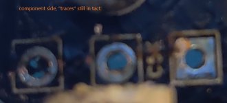

Sizzle lug 1 solder a jumper directly to the pot lug then over to C24 side that doesn't connect to ground
I am taking this in baby steps. It is slightly tricky because certain things can be "backwards" or "upside down" in relation to which side I am looking at so I'm being mindful of this.
When looking at Page 1 of FM PCB layout and zeroing in on the SIZZLE A100K pot:
- Am I to interpret the volume pot lugs for this Sizzle A100K as 3, 2, 1 when reading LEFT to RIGHT where LUG 1 is the SQUARE PAD at the right? If so, My Lug 1 pad HAS lifted.
- If the above is true, then LUG 1 is GND and per my very amateur reading skills of the SCHEMATIC, this LUG 1 actually feeds the "front" or "input" of C24 100n and then the "back" or "out" of C24 100n feeds the GND?
- The C24 box film capacitor on Page 1 of Face Melter PCB layout is the second cap directly below the SIZZLE pot.
- When I touch the C24 side that DOES go to ground (when looking at COMPONENT SIDE this is the right of the cap) I get a BEEP.
- When I touch the GROUND LUG of the SIZZLE POT to any ground, I get NO BEEP.
- If what I have said thus far is all correct, then I should be able to touch the GND LUG of SIZZLE to the RIGHT SIDE of C24 cap when looking at component view and get a BEEP. Right? If so, I am NOT getting a beep, this is why I need to connect LUG 1 of SIZZLE directly to this C24 RIGHT side?
- My amateur reading skills of schematic are not good enough to tell what LUG 2 and LUG 3 do. Have I correctly circled what LUG 1, LUG 2 and LUG 3 are? The schematic has a weird number between the RESISTOR and the C24, almost looks like a 12 or someone made an error?
