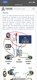

OP: I wired this thing up following their diagram and got a cacophony of noise no matter how the knobs were set, except for Level all the way down. Turning the knobs made some filtering noises too. My guitar signal could still be heard in the noise too, but again, completely unusable. The LED also varied in brightness as I handled the footswitch. I used a 2k2 resistor per the build docs for the LED.
I double checked the wiring diagram with mine. It looked good, but I decided to wire another footswitch in just in case I’d burned up the first one. The LED came on solid but the noise issue persisted.
Triple checked my wiring, jacks etc. Still correct.
So I put another LM386 in the socket. No change.
I re-flowed all my solder joints. No change.
The only difference in my build is that I didn’t use a battery snap, which shouldn’t matter, right?

I can't fully follow all the wiring, but you seem to be missing the connection from power ground to the input/output jack grounds.
Good eye! I added that cable and I’m getting effected signal now, BUT, the last 5% of the Gain knob still causes a high pitched squeal.

some circuits can get a squeal if they are not well laid out, but that usually only happens with very high gain stuff. My impression is that this is not that gainy. I would try with an audio probe so you can at least see which part of the circuit the squeal is coming from. Also, if it is just because of gain, then there are some things to try and minimise it - twist the power supply leads together - use shielded wire on the input and output jacks and ground the shield. Also, make sure the case is making good contact with the ground. I had one pedal that was very noisy all the time, and it turned out that the footswitch barrel was just not grounded - I had used the plastic washer to isolate it from the case and that was a bad plan - when I removed that washer and made sure the actual stomp switch was grounded through the case then the noise stopped.

I have no experience with this specific PCB, but this is a fairly common problem with the Purple Plexi circuit.
Off the top of my head:
There are different versions of the LM386 - Yours appears to be LM386-N1, which I believe is correct.
Lead dress - Keep the input/output wires as short and as far apart as possible
I believe some folks have remedied this problem by bumping up the value of R3.
EDIT: I tried a 47R in place of the 10R in R3, and the squeal at max gain is gone, though I think it loses just a bit of attack/gets a little sponge-y.
