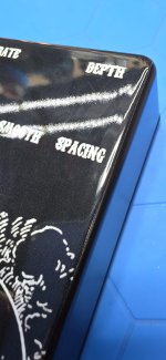

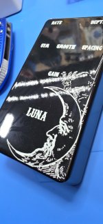

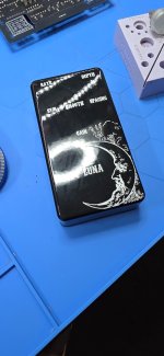

I just received my last test enclosure. For this run, I enabled the gloss layer and used a design from a pedal I built back in 2019. The original artwork was created entirely in Paint.NET for an AionFX Luna.
I exported that original PNG, uploaded it into the tool with gloss selected, generated the PDF, and sent it directly to Tayda.
Attached are:
  • The original 2019 pedal with the printed label
  • The PNG file saved from Paint.NET
  • The new UV + gloss enclosure
A couple comments:
  • It might be helpful to note on the tick box for the gloss layer that this will create a "-V" (high gloss) layer (and not the "-M" matte gloss layer that Tayda also offers.)
  • It does look like there's a loss of resolution on the .PDF compared to the .PNG that I imported. I don't know if it's relevant, but I can definitely see it.
Again, incredible work.

Resolution - The tool uses a "pass-through" method for PNGs, meaning it embeds your exact original image stream into the PDF container without re-compressing or down sampling it. If it looks soft in the PDF viewer, it's likely just the viewing engine's rendering at that zoom level. If you zoom in to 100% or check the file size, you should see the full quality is still there.
Gloss Label: Great call. I just updated the UI to specify it generates the GLOSS-V (Varnish/High Gloss) layer.

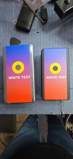

I used the attached PNG to generate the Tayda-ready PDF for some reason it won't let me attach it so here is a screenshot, and these are the results on 125B and 1590B.
White layer mapping printed correctly, gradients came out smooth, and there were no rejection flags from Tayda.
I’m just waiting on the third enclosure with the gloss layer for final validation. As soon as that arrives, I’ll post another update. 1771543413336.png
I’m just waiting on the third enclosure with the gloss layer for final validation. As soon as that arrives, I’ll post another update.View attachment 111747
Not familiar with the White Test, is it an overdrive?
