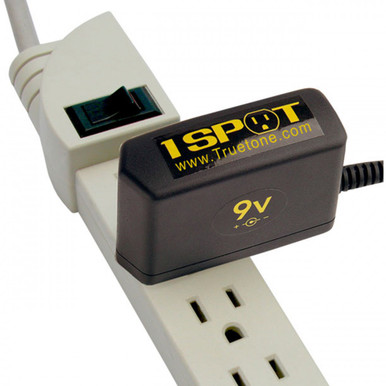

Maybe I'm in over my head here. I built a Thumb Sucker for my son, even though I know nothing about guitars, music or oscillating electrons... I plug it in, cycle the Big Button and no LED blinky. I have no guitar or amp to plug in so, not sure if there is any effect. Looking through previous problems, I see the LED polarity issue and I have checked that the status LED flat spot lines up with the square pad marked "k", as do the two snubber LEDs. What am I missing? Wire colors are: white is IN, black is OUT, green is -GND, red is +, blue is SW. Thanks to all who look at my silly problem and unending gratitude for a solution!
Looks like not. The marking on the wall wart shows negative shell with positive center post. Is there a "standard" I missed along the way? Do I need to find a center-negative one?
Pedals typically use center negative 9V power supplies, which is opposite to how DC power supplies intended for almost all other electronics are wired.
You can reverse the red/green wires coming from the Power I/O module temporarily to test it with the supply you have, but you'll probably want it wired correctly when you give it to your son.
