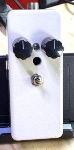

I've had this 1590A enclosure since I started building back in 2022. I've just never had anything to put in it.
And I never could crack the code on doing top jacks on it without major surgery to the enclosure.
Big shout out to @Audandash for his kindness for not only sending me the board with all the components baked on with his hot plate
but also for helping me troubleshoot it when it didn't work hahaha.
Turns out I had a bad switch. And it was my only pin lug switch. So I had to use a different toggle and off board wire it.
Thus the extra hole. Which doesn't really bother me for a utility pedal.
So a couple of cautions if you're building this. It needs a plug in the TRS jack for it to power on. So when you're checking your power make sure you have even a dummy plug in the jack to close the connection.
Secondly, if you look at my pics, the hole for the 1/4" jack needs to be cut all the way down to open the enclosure. There's really no way to get the jack in and soldered other wise. (Ask me how I know......grrrrrrr......
I haven't really found a use for this yet. except maybe troubleshooting with a probe.
Robert told me that it was a "dirty square wave", that's a pretty apt description on the scope hahahah.
