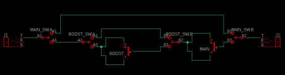

I think I might be running into complications with the design I've implemented---although I'm using two timers, not a dual timer. After talking to a couple of people I'm thinking that because I'm sharing VREF that it is triggering both relays at once. Here's the schematic; I took Robert's simple relay, modified and doubled it.
Modifications are to accommodate a second relay footprint (in the crossed off boxes) for a stock of relays I need to use up, and the pin numbers on the timers are for a combo TH SMD footprint.
For this, I'm wondering if two completely separate supplies are required: VCC, VREF, GND or if only VREF needs to be separate for each.
Again, interested in the post/thread about dual relays by MCU for future use. Thanks.
edit: clarification for the switching situation, either footswitch triggers both relays at once.
