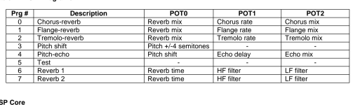

Robert, are the programs duplicated on the eeprom 4x?
There are four programs on the FV-1 that are selected by the Chorus and Reverb toggle switches (programs 0 - 3).
