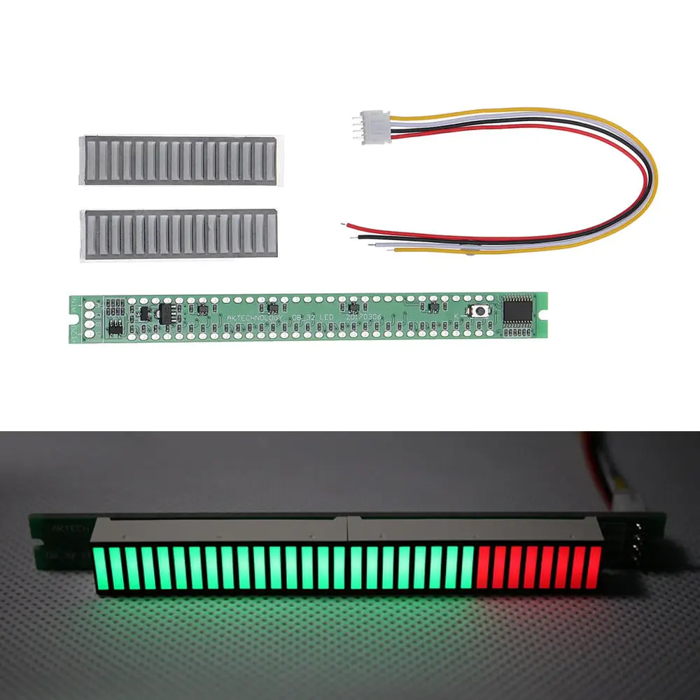

I've been thinking of something similar but using this board/LED vu level...
What I can't figure out is what signal level can it take ? Would a standard Pickup level signal work ?
It’s not apparent to me that it has an integrated driver, so you may have to supply that. It should be fine with instrument level—you’d just need to ensure that the driver circuit is constructed appropriately. Reference the site in the first post for more information there. The strip board layout above is adapted from one of those circuits.
Yeah it's really hard to tell... However the board runs in 2 different modes, one is AGC mode which stands for Automatic Gain Control. So if it can do automatic gain, wouldn't that be an indicator that it does ?
From the technical data I found:
It has dB mode(-40~16dB , for signal monitor) and AGC mode(super wide of AGC adaptive algorithm for better effect).
