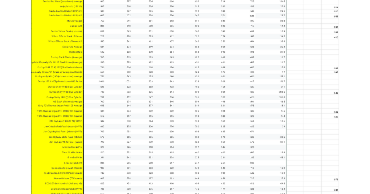

I am planning on an amp build with an inductor based Depth setting. I'd need 500mH about, 2 pins, that's about all the info I got. My instinct was to look at some Wah inductors but the readily available dunlops are pretty bulky and 4 pins (?). A lot of straight inductors are 150mH max and I'm not feeling putting 3-4 in series. Would you guys have any recommendation were to look for a suitable inductor for this use?
Not sure about 2 pins but the Carnhill VTB 9048 has a 500mH tap, also a 200, 300 and 760. A shift switch from 2-3 option could be musical? Or a push pull pot. AML (UK) stocks them but I'm sure they're elsewhere
CAPI has a 1H
Or just get a stickductor
Any of the commercially available inductors will work for this purpose: even the ones that are 4 pin only tend to use two of the four.
The only rub is the value. Most of the commercially available wah inductors are gonna veer closer to 600mH.
The ME-6 is a great value, but its also in the 600+mH range.
If you're looking for something a bit more accurate, mine are *very* available. And affordable. Hit me up over DM and we can talk about my get rich quick scheme.
